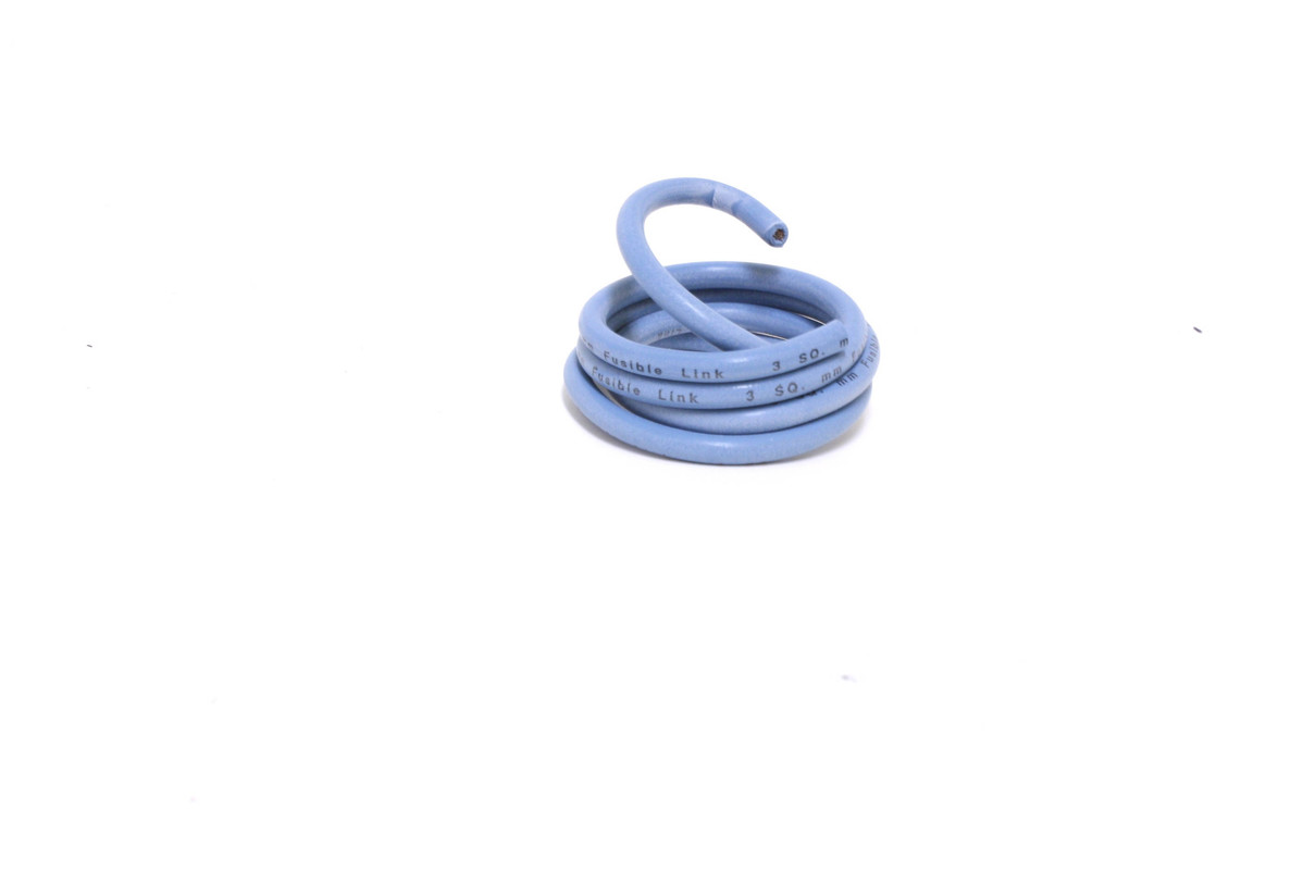

I've been looking for info on fusible links and have found for the most part a length of wire sized by AWG. So, below is a picture of a Fusible Link Wire 14 AWG, 3 Ft
So I am assuming the all fusible links are wire gauge specific. If so, what is the length of the link wire or does it matter? Also I can't find a fusible link wire for any wire gauges bigger than 10 awg. So, for a CS130 alternator conversion where the charge wire is bigger than 10 awg, what do you use?
