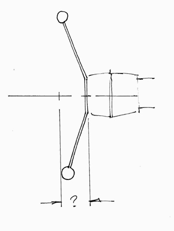

Trying to determine where the bracket needs to be welded to the column. Can anyone tell me what the offset (from mounting flange to wheel) is for a typical Corvette steering wheel is in a C3?
Sorry, just noticed this thread. Do you still "need" the offset measurement? I've got a later C3 wheel on the car, but I still have the stock wheel on the shelf under a pile of dust.
Let me know if the information is still needed/usable.
I measured a stock 1970 car steering wheel depth at 2 3/4". However, I felt like the steering wheel was too close and I understand the steering wheel was moved away in later cars. So I put the seat in my car and loosely mounted the steering column and found an optimal comfortable position for the steering wheel.
