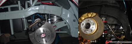

as I understand it this car was restored by the former head fabricator at Dream Car garage (the guy who probably did all the work Peter Klutt took credit for on his two cars)...look for lots of neat tweaks some subtle and some not...I`m not a fan of coupes but this is a nice one.............enjoy...it`s also for sale!
http://s648.photobucket.com/albums/uu201/L72425/

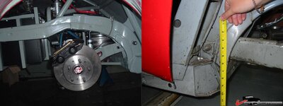

I see a bunch of stuff, first the lower arms have screw or press in ball joints (hard to tell, willing to bet they're screw in) and the position is moved from stock.
The whole spindle, steering arm and caliper bracket look to be a fabricated deal, too bad we can't see it.
The steering box is an internal assist type also.
Obviously it has a custom square stock fabricated center link. It uses keys in slots, where you can change the keys to change the hole location.
Nice to see attention to detail, like the big holes in the door hinges to save weight.
It has a jeep box with the adapter brackets…not what I would expect.

I believe the "slugs" change roll center...notice no trans mount? Interesting the owner of the car was one of Peter Klutts most outspoken critics.....
The roll center is not affected by those slugs, they are used to change the bumps teer characteristics. The roll center is a factor of the susension geimetry (instantaneous center and car centerline), not the steering setup.
The car uses the entire floor to mount the transmission, there's simply a short bolt in crossmember for the tranny. Many 80s and up unibody cars with welded on subframes are like that. I have it set up one mine in much the same way.
You can see it here:
See the bolt going in sideways? There's another one on the other side and possible also some running vertical. That short crossemember ties the 2 sides of the floor frame together and golds the transmission.
I agree that it's kind of a shoddy install of that jeep box, with all the fabrication done to that car, surely they could have modified the frame to position the box lower/in a more favorable location.
