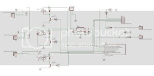

In order to have my onboard computer nicely integrated, I need a device to smartly boot up/shut down the computer.
I design it based on an ATTiny microcontroller. 8 pins (1 gnd, 1 +5v, 6 I/O).
I'm using all the I/O pins, 3 input, 3 output
1 input to sense the car ACC +12v, to know if the car is on or not
1 input to sense motherboard +5v, to know if the computer is on or not
1 input to a switch to force the computer in off mode
1 output to a relay that simulates the motherboard on/off button
1 ouput to a relay that controls motherboard power supply
1 ouput to a realy that controls the optional amplifier power supplier (to avoid pop sound when the computer boots up)
I will connect a 3 state override button, with auto/always on/alway off mode.
So here is the current design, with single side PCB (that's a PITA to make)
I'm looking for any comment on the current design before I start etching a board.
Ok, I realize now that was a bit silly to ask you to comment on the previous schematic, it was a mess.
Here's a revised revision, I hope people with electronic skills here can read
I made several modification :
the 12v sensing is now handled by an optoisolator to protect the microcontroller.
Also, the switching of the 12v source are moved outside the board, I just keep the 2 pin to connect to the activation side of an external car-class 30a relay.

Simply putting the +12v acc to feed the computer wouldn't work, the computer could never shutdown nicely.
Putting the computer on the +12v battery would require me to manually switch it on/off.
There is a lot of wrong scenario I can prevent :
-trying to switch it on while it's shutting down
-trying to switch is off while it's booting.
I just want it to behave like a modern car computer behave.

Ok, there might be a little bit of misunderstanding here, probably me not being clear enough, so let me recap the thing.
I want to install a computer in my car, a PC in a small box to handle all the fancy stuff (GPS, mp3, camera vision). It runs WinXP from a solid state drive, so fast (15s) boot up and shut down.
So I'm installing a device between the computer and the 12v battery.
When everything is off, only the microcontroller in the device is powered, and if correctly put in sleep mode, the power comsuption can be measured in µA.
The microcontroller code is burned in eeprom, so no boot time for the device when I disconnect/reconnect the battery.
This device is also sensing the 12v acc. When it goes on, it will switch on the motherboard power supply, sends the boot up signal to the motherboard, waits for the pre-defined boot time, then powers up the amplifier.
When the +12v acc goes down, it wait for a couple of second (in case the car goes back on shortly), then initiate the motherboard shutdown.
Since it's also sensing motherboard 5v, it knows when the computer actually shut down, then closes the motherboard power supply.
On top of that it will make sure the current process (shutting up or down) entirely completes before taking new orders into account.

You guess right, some of the design is actually inspired by posts on MP3Car.
Off the shelf stuff could be use, it's more about the fun of rolling my own.
