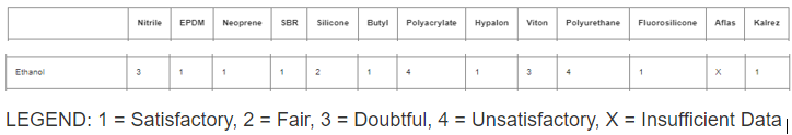

Looks like EPDM, Neoprene, SBR & Butyl are good with Ethanol
