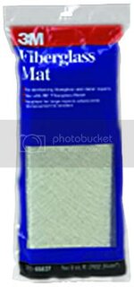

I have never really worked with fiberglass and need to do some glass work on my 74's floorboards. I want to cut out a small section and move it back to make more room for my transmission yoke after doing a trans swap. I also have a few cracks that need to be repaired. So is matting and resin all I will need and what is the best type of resin to use? Any other advice would also be great!
probably smc, so you have to use smc resin and mat. Cut out section and make it so the hole gets thinner towards the middle. I used 80grit to prep my 90's floors. Then make something to form a new contour for the floor, I found metal patch tape works good for forming contours because it holds the shape. After done do the bottom side as well.
cracks grind into them and fill them with mat & resin
after done sand smooth so you will have a finished look, then uncoat bottom repairs and paint inside floorboards.

If you end up cutting the floor, that SMC resin is good for both, fiberglass and SMC.
I think I am going to end up cutting it. Like I said I have some cracks in the floor that need to be fixed and they are right behind where I will be cutting. So I figure this will kind of be a two for one fix.
Right now I have my driveline angles just right so I don't want to mess with that.
Hopefully I will have the mat and resin by the weekend so I can get started on this.
No expert but from what I've read and what I've learned hands on, the fiberglass cloth is a stronger product but harder to get a finished surface. So for the area you're talking about, I would use the cloth. For a painted surface use the fiberglass mat.
Just know going in that the resin will stick to almost anything. So if you want to make a mold for the shape, you will need to coat the crap out of it with wax or release agent unless you want your mold to be a structural part of the repair. Just sayin'.
