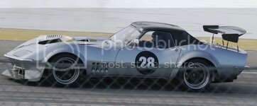

There is a guy in Europe with C6R style wing and splitter on a c3. Looks good in my opinion.
I like his effort, but it is not for the faint of heart.
Haven't seen new photos of this car for probably 5 years.
that is interesting.... I've heard the convertibles with a hardtop are more aerodynamic.... they sure are popular in the race crowds
I also really like his splitter.

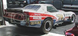

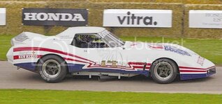

Greenwood ran a real unique spoiler on some of his widebodies. Think of a 80 style rear spoiler with the center cut out and a variable angle wing installed.
This image has been resized. Click this bar to view the full image. The original image is sized 800x533 and has a filesize of 122KB.
It's somewhere in Japan doing drift movies.
