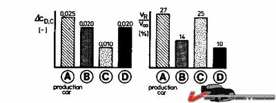

Here are a couple of interesting comparisons:
As an aside, approach "D" is somewhat like what Glen - Love-is-Blue did on the rear of his Vette. Note ther is little drag savings - yet 1/2 the volume of air. Maybe that is why he used 2 radiators? -- Oh, no --they were 1/2 size too?
I believe in the comparison show above the radiators are the same size.

What's the label/units on the top bar chart? I can't read it.
This chart is shamelessly lifted from the text, "Fundamentals of Vehicle Dynamics." I'd like to get my hands on the source which is:
The asian text I took the original posting from had the axis labeled as Delta CWK, which is associated with turbulent flow, and could be comparatively related to drag. The other text is clearer and you can see is Cd.
Hope that helps.
Cheers - Jim
