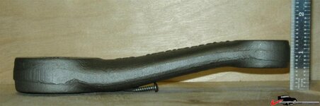

For all looking for a correct pitman arm that will work with this conversion, I have contacted Speedway motors and verified that their pitman arm PN 91032555 is correct for this conversion. The picture below is a 74 Chevelle arn with the correct center to center, drop, spline and tapered stud hole. The Speedway arm is described as:
•5.5" center of eye to center of eye
•Splines are 1.190" outside diameter
•Bottom of tapered hole is 0.675"
•Top of tapered hole is .580"
•1.063" drop
The 1.063" drop spec is what concerned me but I sent these pictures to one of the techs at Speedway and got the following response:
Larry
It looks like the amount of drop is actually going to be .693" which look sto be very close to what you are showing in your picture from the surface it is sitting on the the bottom side of the arm where the tierod bolts on.
Craig Hardman | Street Rod Tech
